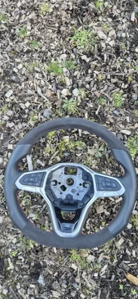

So have an update, thanks to bucky, he recommended 1 of 2 wheels that I could use on my t6.1.
I went with steering wheel 2gm419089t.
This one supports, multifunction, tiptronic and gen2 ACC. It also as all the correct buttons on both wheels accept additional paddle shifts.
I also needed airbag wiring harness 5g0971584R.
This had the correct spade connectors, for the airbag and horn, however it had an additional brown wire spade connector that I will remove from the splice join when I come to refit it again.
It also as the correct 5 pin plug for the new wheel buttons and yellow harness plug for steering module with correct pin layout.
It is complete plug and play with no coding. Everything works like the old one including the dsg shifters.

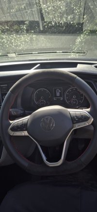

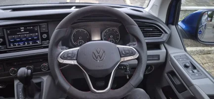

All fitted now.
Pics of existing wheel, part number of new and new one fitted. Straightforward plug and play.
