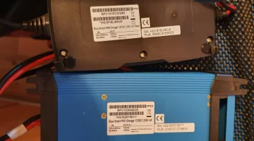

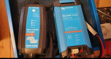

@Dilbert I've had my charger 4 weeks and for sure it was not capable of VE networking until I got the FW update on Friday. I did try.
This was the 2nd update since I bought it. So I think the last update (3.4) was the VE enabling FW.
Yet until about 4 days ago Victron support have been telling people (and it was on their website) that the microprocessors in the charger were not capable of this.
One of the guys on FB is not a happy bunny. He bought his charger 9 months ago in October a good few months after the newer version came in.
Still being told yesterday morning that he has an older version that will not VE Network so he has been sold an older model!
Ill have to check mine....
Prob older v1 as had them a year..
looks like mine are 2018 so Rev#1 editions - No VE on these then.
though they do have the history logging now . . . . which is nice.
thanks for the link @Dilbert
WOW thats a nice update. . . . @Mick look at the changes.
