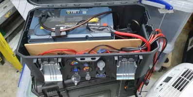

New Battery Box with the 100ah Poweroad PRLC-100
@DEH and @Mick

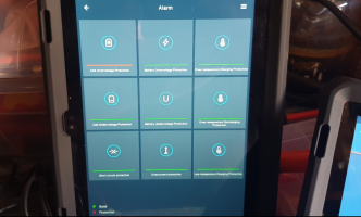

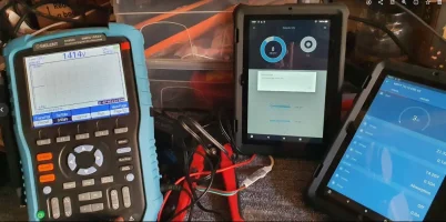

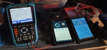

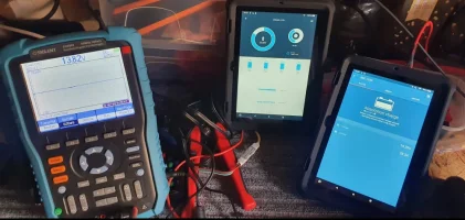

I've been testing the PRLC-100 battery and was wondering about @DEH comments above "overcell voltage warnings" from the battery?
in nearly all of my testing the warning was triggered at the top 95-100% mark.
this was using a variety of chargers, but mainly the Victron units. . . that have a 14.2v charge in the Lifepo4 profile.
The PRLC-100 spec sheet states that 14.4v should be used (so 14.2v is perfectly fine.
testing wise, i have been using:
Portable scope in voltage logger mode,
Bm2 voltage monitor
Poweroad APP on a tablet
Victron APP on a tablet (both SMart shunt & MPPT & Charger

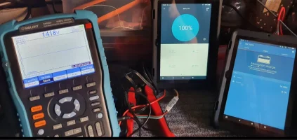

you can see the warning here:
we know from previous testing that the battery cuts out at 10v and has a top cut off as well.
what was no so certain (compared to other batteries) was why the warning was coming up as if it was an issue?
here you can see cell#1 at 3.69v with the battery still charging @ 3.15A . .
then the warning pops up and the charge current drops to 0.0A . . .
the warning flag is set . .
but the battery voltage stays on and fine. . . . still able to delivery power to any loads . . .
so the testing shows that the battery BMS is just working normally and cutting OFF the incoming charge current, while still allowing the outgoing LOAD current. . . . which is normal.
SO . . . .
why bother with the battery warning . . if this is just normal BMS operation?
It looks to me that the system is working as designed . . . but i think that the warning can confuse matters for the end user.
i think the warning should NOT pop up during normal operation . . . but only when there is a problem outside the spec.
it looks like the APP programmers are giving us all the information . . which is nice. but maybe just do that bit in the background.
for example i dont need to know that the BMS is cutting off the charge current every day when the battery is FULL - thats just normal . . . not a fault that needs a warning.
i wanted clarification . . so i reached out to Poweroad again . . .

so they have confirmed on how the BMS works . . and have given us the documents --- Finally we now know what the BMS is fdoing
Thank you *** !!!
this is what the document shows.
cell over voltage:
3700mV+- 20mV
to that means that if any cell voltage rises above 3.68/3.72v the BMS cuts the charge current.
it will hold that state untill the cells drop to:
3.47/3.43v at which point the BMS releases the charge hold and the battery will resume charging.
so its just normal operation of the BMS . . .
i think they need to update the FW and app to remove the warning as the end user doesnt need to know that - its not a fault.
we also now have the full BMS manual . . . OOOSH !!

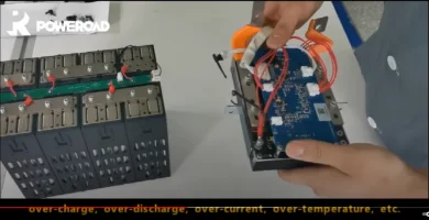

I am surprised to see such a wide variation in cell voltages. The Valance LiFePo4 battery, for example, rebalances when a cell is above 3.36V and >40mV above the lowest cell.
Would be interesting to know what the rebalancing criteria and algorithm are for this battery.
@Dilbert
we don't know the exact criteria . .
but the supplied technical document they provided gives us some insight . . .
it shows that the BMS will start top balancing when any cell reaches 3400mV +- 50mV (4x cells per battery) (4Sx*P?)
and that the turn on differential is 50mV
i can only assume that as these batteries use LFP Pouch Cells that they have a slightly different absorption rates to standard 18650 cells?
maybe they can absorb faster/slower than each other creating a slightly larger cell mV gap?
this guy shows on appart:

which may have a different BMS setting . . . . But isnt LOW-TEMP. - so isnt an ideal solution.
The SLEEP thing is causing issues with the monitoring.
where its going to SLEEP due to the loads being less than 1.0A its shutting off and resetting my monitoring.
not a major issue i know . . .
this is not a normal install as the battery is sitting in a battery box and not installed on a RV/Van. . . .
but you can see the effect here on the BM2 monitor.
a fragmented Voltage plot and a constant reset of values on the Victron smart shunt. (last 15days)
we asked Poweroad about this, . . . . . . and maybe asked if the SLEEP time could be increased to get around the issues.
we did get a relpy:, so thank you Poweroad.
Hi Dellmassive,
Thanks for the suggestions, I will forward it on the tomorrow meeting with engineer, to see if it will add the sleep mode into App.
About your questions: "why is it switching OFF and ON at different intervals? – is it sleep event?"
example- 19/07/21 - battery OFF 0000hrs till, 1300hrs then ON to 2230hrs then OFF? Voltage stable at 13.2v . . .? why?
I wonder if the battery triggered any condition of sleep mode automatically during 0000hrs~2230hrs, so it switching OFF and ON at different interval.
I guess there was a current (>1A) at 1300hrs, so the battery ON. Because in the idle state, only the charge/discharge current less 1A, battery will open 24 Hours timer and ready to sleep, however, once it detects there was a current which is over 1A during 24hrs, the timer is cleared to 0 and out of sleep mode.
B.regards,
Poweroad Tech
