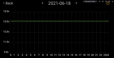

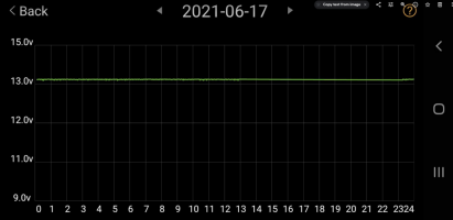

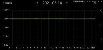

so if you want to stop the battery sleeping, fit a BM2 to the battery? - that's all that's connected to mine.
Now:
1624137960900.webp1624137969492.webp1624137981404.webp1624137991596.webp1624137998772.webp1624138007324.webp1624138014322.webp1624138021545.webp1624138027974.webp1624138034695.webp
to test the point ill disconnect the BM2 now and see what happens over the next 24/48/72 hrs . . . . . .

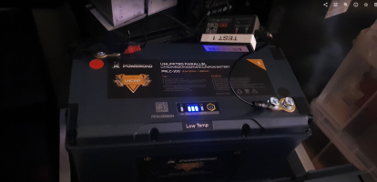

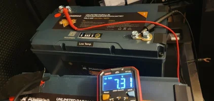

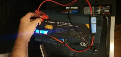

After the battery test being awake for 7days.....
I removed the BM2...last night..... i just checked the battery... guess what.
Its sleeping !!!! (That proves that the bm2 was keeping it awake)
10mins ago.

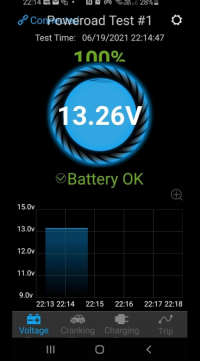

So i added a multimeter.... just the 6v is monitor voltage... still sleeping.
I tried the APP..... no conection.
I attached a clamp power meter.... no change.
I touched on the BM2 and the battery come to life.....
That tells me that the battery is monitoring the power in or out over a 12hr , 24hr period....... if no power flow it will self sleep shutting off power to the terminals.
But a BM2 in testing will beep it alive....
That would mean the the BMV712 is super low powered and below the point that the battery will reset the power usesage timer.
So if you want it to stay awake all the time and keep the bmv712 powered.... either fit a BM2 or try leaving ur solar charger conected?
