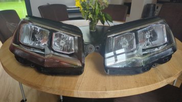

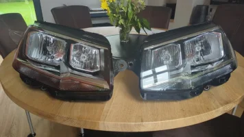

And they are in:

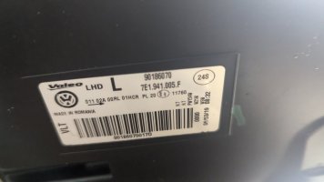

Build in 2019, revision "F" headlights.
Very good condition

Do you have the original DRL holders or the later F/G revision H7s?
I guess the only way to know is to get your old bulbs if you still have them, and do the 45 seconds (out) / 45 minutes (in) replacement dance.View attachment 281705
Yep, see quote/pictures above, 100% sure they are the F variants.

Fs and Gs aren't that common on ebay, lots of original and later revisions come up.Just started the H7 journey, fairly new T6 owner and a few weeks ago I drove Gospel Pass at night and FM the H4s are rubbish
Managed to find a reasonably priced revision G H7 for the passengers side but not found a reasonably priced drivers side yet. There are earlier revisions available, however, been looking for a replacement DRL bulb holder for the earlier lights and they are now £45 for 1![]()
