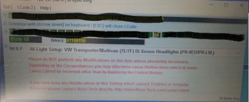

Afraid it was unsuccessful, I now have scans of a couple H7 equipped vans and had a quick play with @Ed Webb van at busfest, I tried coding the obvious bytes and it didn't work and was reluctant to go too far with it as we were sat in the dark and ed was about to head home that evening so I was feeling a bit twitchy
I think a bit more research is required and will revisit another time

It can be done with coding to perform as per factory we just need to figure it out

Those VCDS entries are incorrect, they have not been updated for T6s I have scanned dozens of vans and found
H4 = 71
H7 = ?69? (Need more to confirm)
LED = 73
