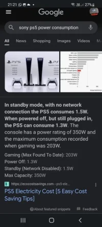

PS5 is rated at 350w
Thats 4.5A 30A @ 12v. (Max)
But the PS5 will need an inverter to get the 240vac... Then factor 85% conversation efficientcy.
So I'd expect 10-25A draw from the 12v system when it's running..... That's a fair load on a SLA battery.
You won't get much run time..... May 3-5hrs untill the battery will be flat.
Shows how out of touch I am with gaming kit. At that power level I would only use it on hook-up !
Pete
350w @ 12V is close to 30A
It is 350w at 220v.
My AEG 1500w inverter display reads 110w at 12v.
