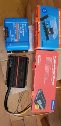

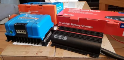

Here's my Orion isolated....
And AMT12/2 here.

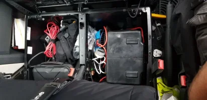

Post some pics of your install and we'll take a look.
