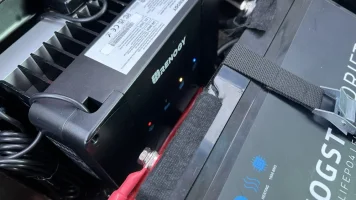

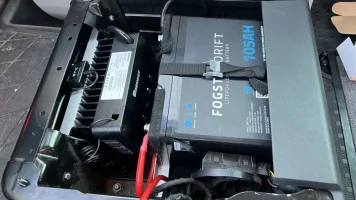

First bit of my leisure battery, dc-dc and solar complete….
I used 4AWG wire for all positive and negative from van battery and to hook it all up.
Had the van on idle for about 1.5 hours to fully charge the Fogstar 105ah.
Whilst using all 50a from the alternator into the Renogy, the wire from the van battery to fuse and then to the Renogy input got hot to the touch and the insulation lost its stiffness.
Is this right?
I reduced down to 40a and it seemed better.
Thoughts?
You're being a bit hard on the battery at a sustained 50amps, Fogstar recommend closer to 30amps per 100ah capacity.
Downrate the DC-DC to 30amp and everything will run cooler and happier, save the high current for those occasions you really need to charge the battery hard.
Is this right?
Thoughts?
I wouldn’t expect 4awg (25mm^2) cable to get hot to the touch passing 50A.
This graph gives a general idea of temperature rise vs current for different wire sizes and it indicates that the temperature rise should be negligible.
A high resistance due to a bad connection / crimp?
