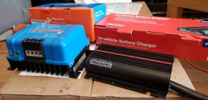

I personally have been running the Redarc BCDC1240LV,
and will be upgrading to the BCDC1250D shortly (added Lifepo4 battery + 50A throughput)
I will also be getting a Victron 12/12/30 to test (to see if it will work with VE-Direct)

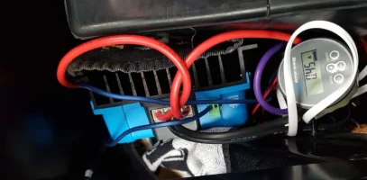

this is my 12/12/30 connected to the stock oem battery under the seat 75ah
i also have a 500A BMV712 battery monitor that i can monitor the current flow in/out.

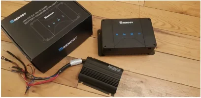

and my 50A Redarc
and 50A Renogy.
all fitted and tested in same van. . . . . no issues.
