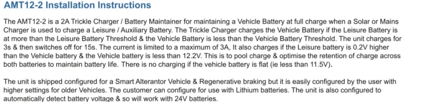

you can use one 240v charger to charge both batteries . . . as seen here: https://www.t6forum.com/threads/battery-chargers-how-i-did-it.10812/post-349602Hi all, I’ve just fallen foul of the no reverse charge from Redarc and solar . Van is dead.
I like the idea of the ablemail trickle charger or the battery master. But is it possible to fit alongside the Redarc whilst using it as a solar charger or is it for use with separate DCDC solar controller eg require a more major re-jig of the setup I’ve just completed.

post a few pics of your Redarc and setup and well have a look.That looks great. Thanks for the excellent reply. Was hoping it would be possible to add this to my set up rather than change everything. I will go and order one now.
so I can think about where I should put it, I’m thinking that I can connect the the leisure battery and positive feed from the starter battery that come through under drivers seat.Does that sound ok? Do I need acces to this device long term to tweak etc or is it connect up and it’s all good?
