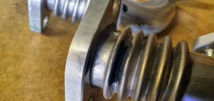

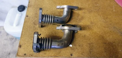

@Dellmassive
There you go Sir.
Old one against new pipe, and no modifications.
This is the one i've just changed after around 24k
This is the original one from new, that I changed last year after around 30k
I suspect the new one i've just fitted will do around the same mileage. As mentioned above, it's not a big deal because it's a cheap part, and an easy job to swap over.
The first obvious symptom will be the smell of exhaust fumes coming into the cab, and the confirmation is the hissing coming from behind the engine.
