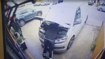

all done, the VW Assist guy had it done in 15mins with me chatting to him on the driveway whilst doing it.
no special tools . . . just a 1/4 inch small ratchet,
with a small 1/4 inch extension bar,
and the splined bit for the bolt.
he just took out all four bolts one at a time . . . just feeling blind.
then took out the old, and swapped for the new.
again replacing the bolts one at a time.
one small tip was that he used electrical tape to tape the bolt into the bit, when refitting them - to stop the bolt from falling off.

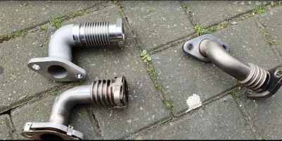

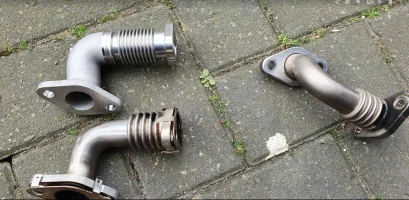

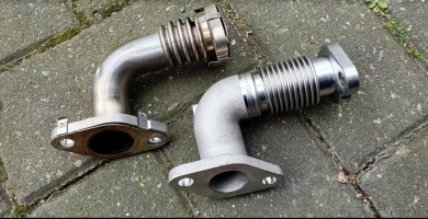

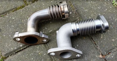

this is the old and new unit:
common problem as he had a second faulty one on the van . . . .

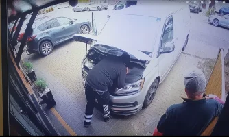

he done it all ftrom the topside just reaching down . .
and the paperwork for it . . .
this is how he reached it.

1617810626963.png1617810644332.png1617810655753.png1617810673727.png1617810718352.png

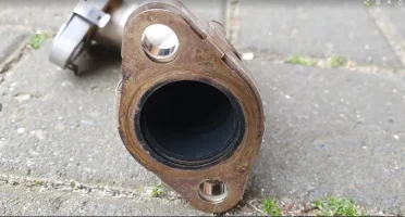

you can see the fatigue crack here:
its a very small pipe . . .
