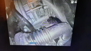

Look below the orange intake hose, right rear of engine.I can't find the rear egr pipe on a 204 engine, spent 10 mins looking, and no luck.

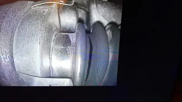

Eventually found it with help of an inspection mirror, no chance to see it otherwise. Looks good, can't see any obvious signs of soot but I do get a wiff at start up.Look below the orange intake hose, right rear of engine.
Looking at the access its a pig of a job! I have the 204 engine so access isn't so easyGot my new pipe fitted the other day. Very fiddly to do but I am quite slim so managed ok, took maybe 1.5hrs. No fume smell in my cab now and probably 7/8 more miles to the gallon.
My pipe was split in the same place.
