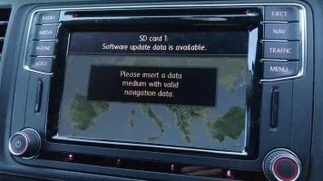

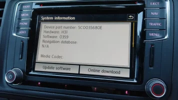

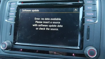

No I initially wiped the original card, used the wrong files as you point out @Pauly .
I then used a 64gb micro SD card end extracted the new zip file to it.
The result is as per the attached photos. Grrrr.
It is a step closer though.
Not got the contents screenshot of the card to hand at the moment though.
@Diesel9a1 It recently took me 3days to update my golf sat nav and I got sick of the warnings above. First of all I reformatted the original card then tried but it said card wasn't large enough so I bought a bigger card but despite what the website says about using any SD card it only accepted the original. It won't accept micro sd cards in an adapter either.
I am not a computer whizz by any stretch but I found out when you format a card there is a setting in the menus on the left before you do it about how much space will be used during the formatting. I selected the default one with no value against it, this then meant there was enough room to hold the required files. I then download the files and unzipped to the card. It now works fine (as well as a VW sat nav is designed to anyway)
I hope that makes sense, if not I will try and link to the original post I found if I can find it again.
Good luck

Are you able to post a screen shot of what shows on your Mac when you first go into the SD card. The final piece to my jigsaw was that the unzipped folders got put inside another folder on the card, I had to move the contents of that folder (think it was 2 more folders) out to the first level then delete that first folder as it was then empty. It then worked fine.
Well that didn't work out too well. Update didn't work and now the back up I did also doesn't work. Both on original sd card.
I'm certain its something I've done wrong or maybe because I'm on a mac but van is booked in on warranty work next week so will get them to fix it. :-(
if on a mac you need to format the SD card in FAT format before you start.
Heres the pics but I think the problem stems from I didn't format that card. I sent it to the recycle bin and that probably deleted some hidden system files on the card.
As previously mentioned. I'm sure its my fault and nothing to do with the update.
Screen Shot 2017-09-18 at 17.47.07.webp Screen Shot 2017-09-18 at 17.47.07.webp Screen Shot 2017-09-18 at 17.47.23.webp
That all looks ok, you may well be right if you haven't formatted the original card. Give that a try and see how you get on. Good luck
