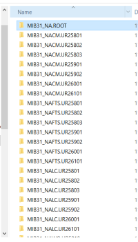

But what I did is that I downloaded the bundle for Africa and Middle East which include Egypt (https://navigation-maps.volkswagen.com/vw-maps/NA_10PR095_CT3W-221G0_Offline_Update.tar), I got a USB-C Stick and unzipped the maps directly in the stick.
This is what I have in my USB stick.
I followed the steps like here: https://app-connect.volkswagen.com/mapupdates/manuals/Discover_Media_Gen.3_November_2020.pdf
But I never got the maps updated. I left my car running for more than 30 mins and I did not get the navigation database update, is there any recommendation how to do it?
