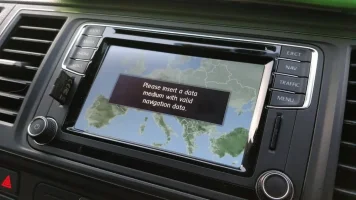

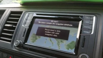

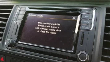

Followed this:
https://goo.gl/8NFnDC
Extracted the FULL 7z file to the sd card.
Put in head unit after it booted up.
Menu / System / System Info / Update
Result was: as per the screen shots.
Bugg3r, I've now lost sat nav. Any thoughts on what I'm doing wrong?
