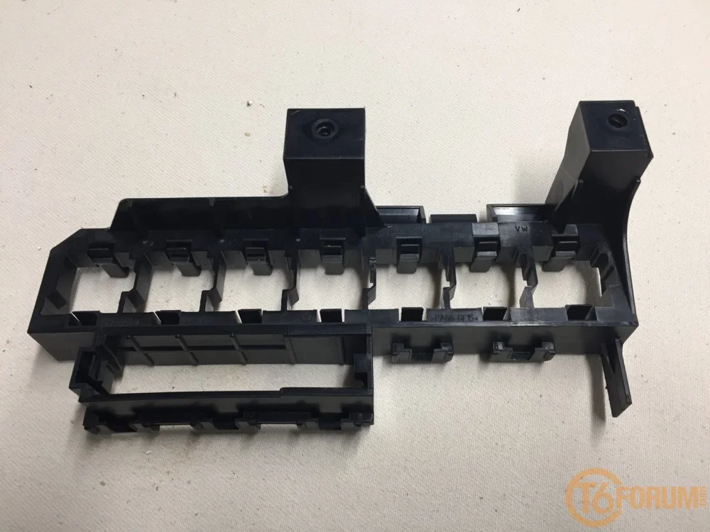

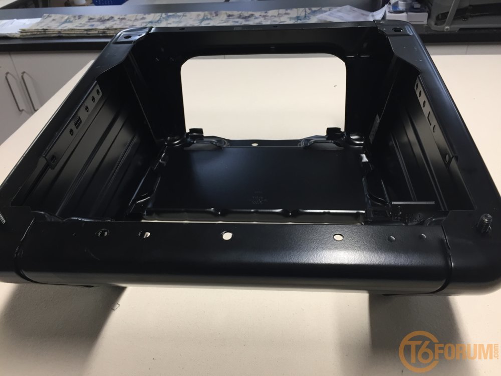

Today I’ve started my dc-dc charger install. It looks fairly straightforward. There’s a relay under the passenger seat with two thick red cables which must be the charging relay. Along with the battery cables there’s a brown and a black wire. Brown I assume is the earth for the relay and black must be the signal from the BCM. I’ve removed the battery and all the connectors and fuses from under the seat and removed the seat base

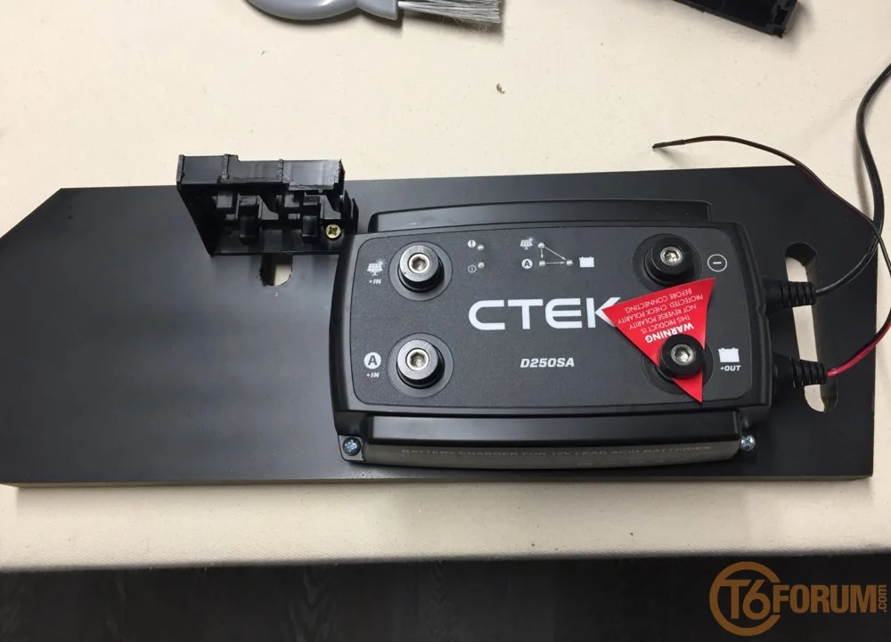

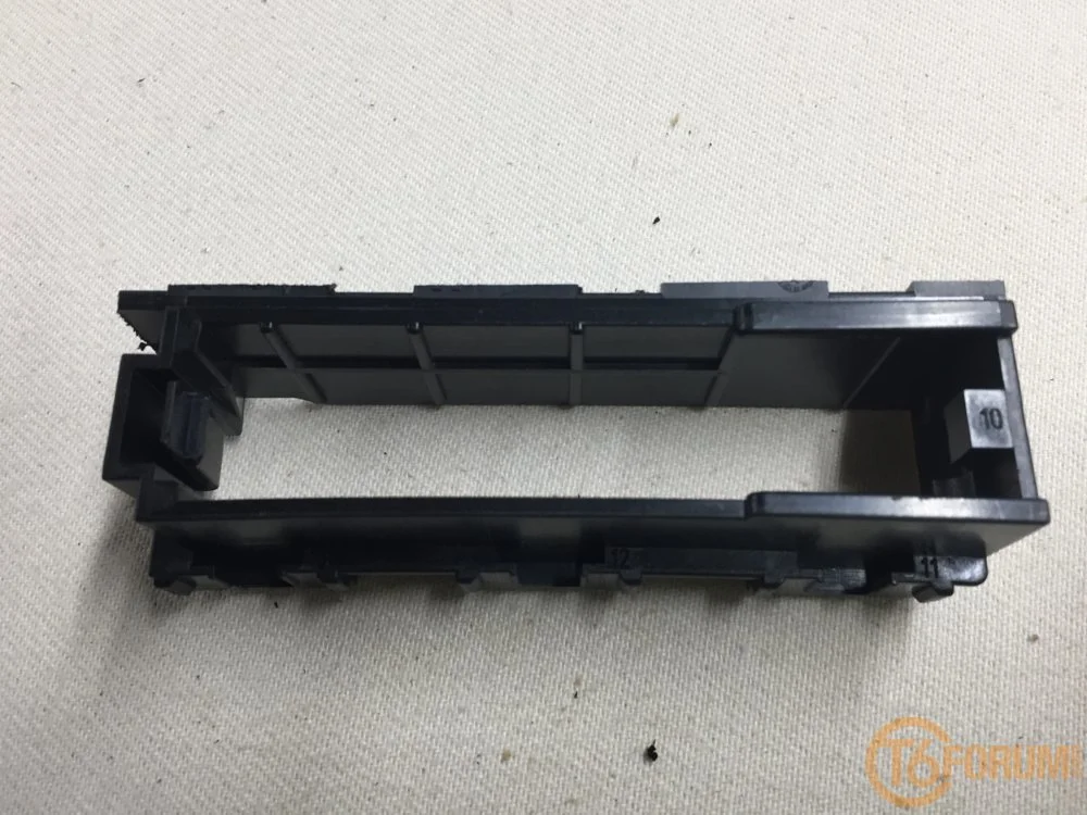

I was hoping to fit my amp under the seat as well as the C-TEK charger but there isn’t enough room. I decided to fit a board in front of the battery to fit the charger to and a new fuse box for the leisure electrics. After removing the plastic bits that hold the fuses under the seat, I decided to cut them down and try to reuse them
After cutting down

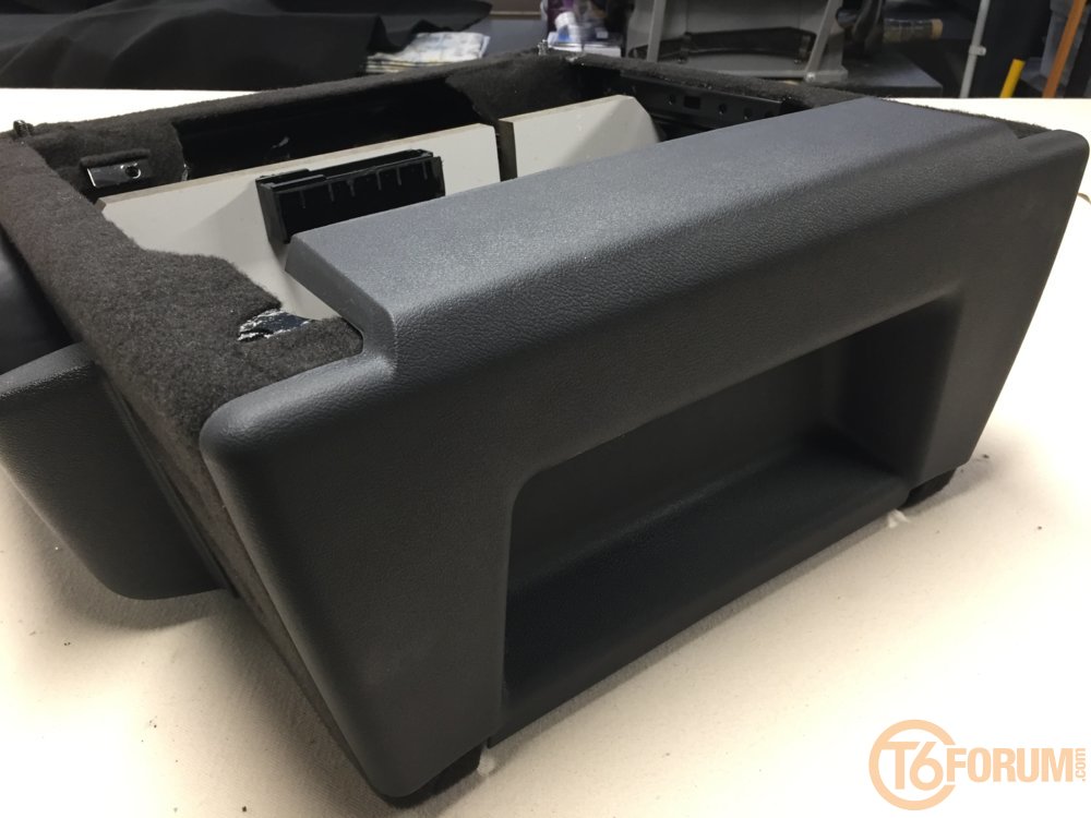

I fitted the charger to the board I cut and screwed the fuse holders on, then fitted it all into the seat base
When I was happy how it all fitted I carpeted the base
The base is now fitted back into the van and the battery re fitted.
With the seat fitted and swivelled around all the fuses are accessible. The indicator lights on the front of the charger are visible at the front of the seat
