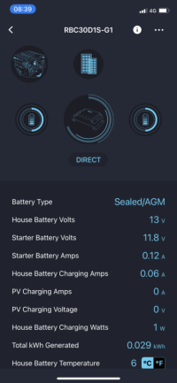

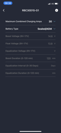

I am finding recently that when then engine is running, the leisure battery is being charged at 15V, despite the fact that the charger is set to the factory 'AGM' setting, which has max boost voltage of 14.6V. It's also charging at 9 amps after an hour driving (and a couple of hours driving the day before).

Screenshots of the Renogy app attached for info.

Yes I have a temperature probe installed against the battery. The Renogy unit monitors (and displays) battery temperature and also the temperature of the charger itself, with cut-offs set for over-temp. I can't find anywhere that allows me to adjust temperature compensation but it is true that I have been testing it recently on cold mornings/evenings, which coincides with this apparent increase in charging voltage. Thats reassuring to hear that this voltage is consistent with your Votronic. I will dig a little deeper to see if I can find anything on this compensation.

Ok checked again and now I know the correct terminology, the info was there. If my numbers are correct, this all makes sense.....
Renogy Temperature compensation coefficient is -3mV/°C/2V (x6 cells = -0.018V/°C).
Nominal charge voltage at 25°C is 14.6V.
Temperature during test was 4°C.
4°C-25°C = -21°C x -0.018V/°C = 0.36V.
0.36V + 14.6V = 14.96V (so 15V).
This also looks to tie up with my battery's preferred temperature coefficient on the spec sheet.
