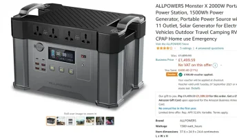

ALLPOWERS Monster X 2000W Portable Power Station, 1500Wh Power Generator, Portable Power Source with 11 Outlet, Solar Generator for Electric Vehicles Outdoor Travel Camping RV CPAP Home use Emergency ALLPOWERS Monster X 2000W Portable Power Station, 1500Wh Power Generator, Portable Power Source with 11 Outlet, Solar Generator for Electric Vehicles Outdoor Travel Camping RV CPAP Home use Emergency : Amazon.co.uk: Garden & Outdoors
Does this represent good value in terms of being a simple all in one power solution that would run pretty much any device you're likely to take with you?

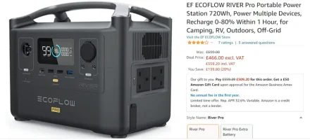

The ECOFlow Delta unit I have has a UPS feature that does that.@Dellmassive - Possibly a real noob question but bear with me.
I have question re Ecoflow and similar units. I have modest charging requirements that merely consist of charging an ebike whilst driving between tracks (2-3 hour durations) plus beer fridge and the odd usb powered device.
Most usage and charging would be whilst on the move with maybe a requirement to continue charging for a couple of hours once parked. I currently just use a 1000W inverter for whilst on the move but then have to keep the engine running if I need to continue charging after arrival. It would be nice if I had capacity for a couple of hours further charging.
I know I could install a leisure battery and b2b charger to feed the inverter and probably achieve what I want if sized correctly, but could an Ecoflow or similar achieve the same. The crux for me is the load switching. My current setup has an inverter with a remote control so I can switch the whole system on from the cab remote by switching the feed to the inverter, without rummaging in the cupboard where the inverter lives to switch outputs on etc. Can any of the Ecoflow type devices switch on and supply their load on just by sensing the charge circuit coming on and off.
