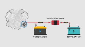

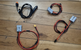

The questions I have are around the charging of the power station using DC input. As mentioned above, there is a DC5521 to cigarette lighter lead included with the VDL unit. I hate cigarette lighter sockets and cables and want to know what options are available to charge the power station off DC while having future ability to add solar panels to the setup.
Initial thoughts are to purchase a DC DC battery charger: would something like a Victron 12v 12v 18A be sufficient and avoid causing any issues to the alternator ( I believe is rated at 140A on my 2020 T6.1 2.0TDI)
Second thoughts are do I need a battery charger or can I just connect to the vans battery/alternator directly with the power stations DC input?
Thirdly, can I rewire the cigarette lighter and utilise (Anderson or similar to XT60) connection to the power station and (trickle) charge from there?
