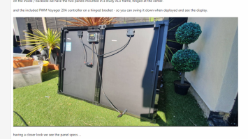

have a look at the RENOGY Suitcase kits. . .
basically built like a "BRICK DUNNIE" compared to the normal foldable fabric style.
the good - bombproof.
the bad - large size, for transport and storage.
My Panels:
Those do look good, look like essentially rigid panels with a neat frame and case?

Those do look good, look like essentially rigid panels with a neat frame and case? - Yep
