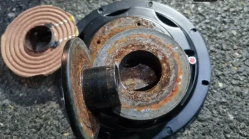

i finally had a chance to to take the door card off. . . .
this is what i found.
we see signs of water / moisture here splitting the MDF speaker rings . . .
not looking good here with the speaker bottom showuing evidence of water damage. . . .
with more signs of corrosion here . . .
the speaker cone was stuck solid . . . so the assumption is that water had go into the speaker and corrosion had stuck it solid.
but why . . .?
well i didnt follow the advice above about fitting the water shield / water guard. . .
or even using a sheet of sound deadening as a shield to prevent the water damage . . .
i suppose I've been lucky that its taken 4 years to effect me. . .
so what now . . . . . we the speakers is knackered.
I've ordered a replacement set of speakers with new rings and water rain guards. . .

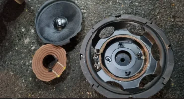

untill they get here lets take a look at the speaker to see what happened. - it wasnt what i expected.!!!!

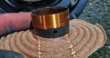

the cone and spider was stuck fast, so i had to cut them out. . .
i was expecting the coil bobbin to be rusted and corroded and stuck fast.
but i wasnt !! - it was clean.
BUT i was stuck?
so why was it stuck?

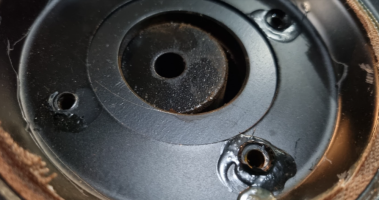

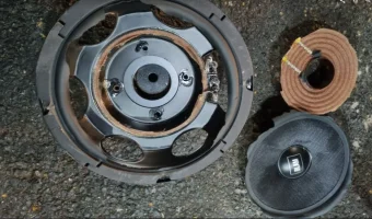

well look at the centre section that the bobin sits over . . . its not centre and pushed over to one side. . .
thats what was holding the speaker firm.
but whats caused that?

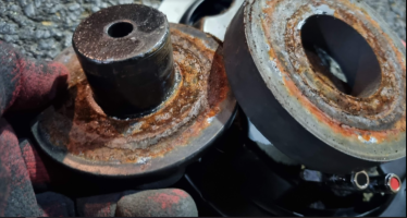

well stripping the rear motor assembly appart we see this. . . .
now we can see whats happened. . .
water from the wet side of the door has run/dripped down from the window rubber into the top of the speaker. . .
this is why you NEED TO FIT A RAIN COVER ON T6 FRONT SPEAKERS.
the water has wicked into the motor assembly and started to rust. . .
the rust has grown and started to push the components appart. . .
even though the magnets are extreamly strong and to break them appart needed great force. . .
the power of mother nature and the rust was no match for this speaker. . .
this was the cause for the speaker failure. . .
the centre guide was pushed off centre by the growing rust and eventually pinched the bobbin fast and jammed the whole unit solid.

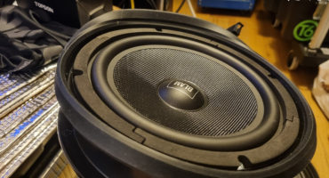

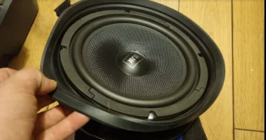

well . . . . they finally arrived - so thank you supplier, but not what i expected.
i was expecting all the component parts. . .
but they have come all assembled ready for fitting. - which is nice?

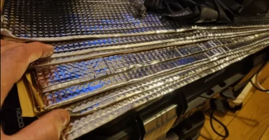

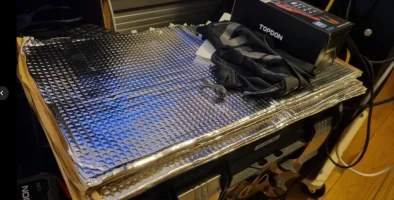

weve got 8x sheets of sound deadening . . .

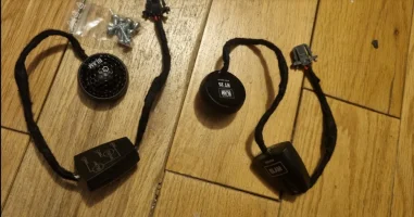

one set of tweeters already prepped with the OEM VW connectors on. ( not sure yet what they chose 0db or -3db)

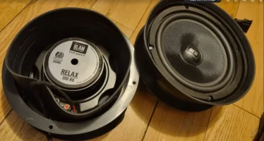

then the speaker + mount ring + rain guard + oem wire plug - all pre assembled as one unit ready to go !!!
the VW conector is glued through the ring ready for connection at the vw oem point . . .
the rain guard extends to the front. . .
and most importantly the raer of the speaker c. . . .
sweet . . .
very nice . . .
so basically from this point . . . all we need to do is remove the old speakers. ( or OEM speakers )
and replace with this set, using the supplied screws.
a nice surprise?
or would i have preferred to assemble it all myself.?
well currently im ubber busy so having the kit pre-assembled is a good thing.
if i had more time i would have like to assemble myself . . . . but the end result would have been the same . . . . so? (maybe pre-assembled has saved me some time)
for average Joe, its a good thing as they are just a - remove and refit kit.

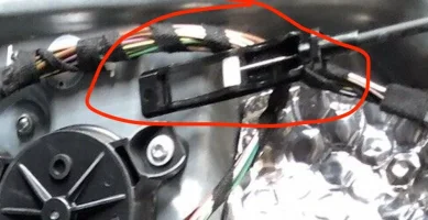

Although my passenger side install went well, on removing the drivers side front door card, the detachable catch for the internal door opener broke, it snapped. I'm not sure what I did differently to make it break, but that's life! I was able to stick the two plastic bits together with some gaffer tape but assuming that is not going to hold, does anyone know a part number or even the correct name for the part? Here it is, there's quite a big bit missing which I later found on the ground :)
Here's a similar part although I think this is for T5 rather than T6.
Thats the pull handle catch.
The beldon cable that goes to the lock assembly.
