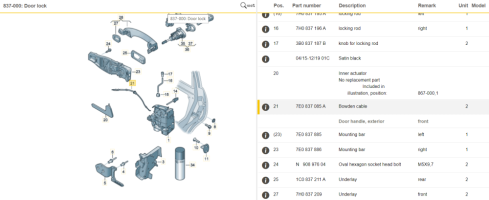

Thanks!Thats the pull handle catch.
The beldon cable that goes to the lock assembly.
Can anyone (e.g @Pauly ) provide a part number please?
To my amazement, I was able to get enough rigidity to clip the pull handle cable mechanism back into the door card and it held whilst I manouevered the door card back into place in the door. I am highly doubtful that it will last, but at least the door is back together so I can enjoy my new speakers for a while before I have to dismantle the door and replace the cable properly.Although my passenger side install went well, on removing the drivers side front door card, the detachable catch for the internal door opener broke, it snapped. I'm not sure what I did differently to make it break, but that's life! I was able to stick the two plastic bits together with some gaffer tape but assuming that is not going to hold, does anyone know a part number or even the correct name for the part? Here it is, there's quite a big bit missing which I later found on the ground![]()
