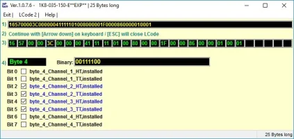

Pauly, I'm sorry I didn't have a 'Drop Down menu', I just had this :
Now this is probably because I have an older system but all I did was check the boxes on the Channel 1 and Channel 4 and then I 'Did it' and the fader was instantaneuos active. No going to sleep time or turning off.
Now I've got an older system, I don't mind it sounds ok to me and I have put this up so that anyone else has the problem they will know.
