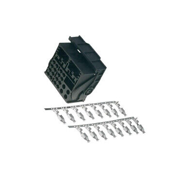

Hi all. I cannot find these connectors anywhere online, four connecting rear speakers into the quad lock. These two links have gone dead as they’re quite old. Can anyone help please?
This was £8 for the set, and I just needed 4 of the connectors. Worked a treat.
If anyone comes across this post, and needs these crimped connectors for the speaker block, drop me a message. I’ll post you some.
