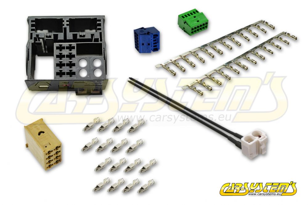

Hello chaps. All the links to connectors are dead now. Would anyone who has been through this cast an eye over this link please, which suggests that the connector code is
JPT Terminal N 906 845 05
Which seems to align with what @Deaky said a bit further back in the thread.
Many thanks
I think I used these
