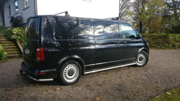

I have my winter tyres on size 235/55 r18 on amarok Steel wheels, and I think that is almost the maximum I can have whiteout the tire rubbering something.
The car have - 40mm lowering.
The speed dial shows 1-2km/h to much.

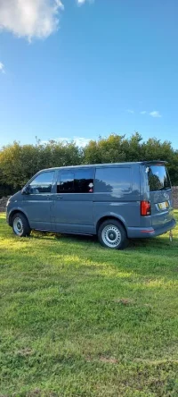

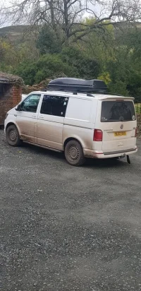

On standard suspension, no spacers, using amarok steels I have run 235/55/18 and 235/60/18 and both sizes are 100% perfect. No rubbing in any situation even towing 2.5t across rutted tracks.20200905_181954.webp20191018_135330.webp
