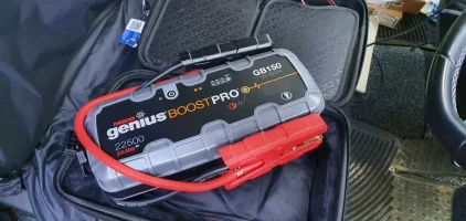

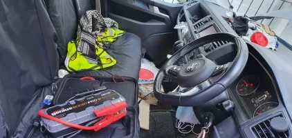

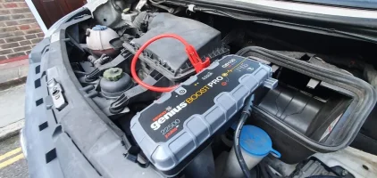

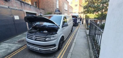

NOCO GB150 for the win . . . . . Again.
arrived at work at 7am . . . . double parked on a double yellow. . . . . .
so left the Hazards on and started unloading. . . . . .
6 hours later we had finished the job and had no ticket . . . . result i thought - free parking =] ( A rarity in London)

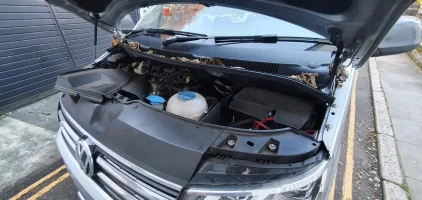

The Hazards were still flashing away, so in we jumped and went to start the van . . . . . Nothing !!! IT WAS DEAD AND DIDNT TURN OVER.
Out come the GB150 which i always have in the back, all charged and ready to go.
connected it direct across the T6 battery for a quick jump start.
started straight away . . . Happy days.

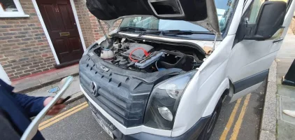

we went to get the guys that were parked behind us to move there van . . . . . . . guess what !!!
same thing, there VW Crafter was dead too . . . . .
lucky we had the GB150 to hand.
The crafter had a remote battery somewhere, but WV had left jump point in the engine bay..
so just connect up and boom started first time. ( The Crafter guys were well impressed )
and the GB150 was still showing 100% charge.
Happy days =]
off home we went for a Beer and a Pact on the back. - A Job well done.

I'm baffled by the energy decal on Lee's Noco 150 - 22500 joules is a piffling amount, equivalent to half an amp hour at 12v. Noco claim that the internal battery is 24wh, which is four times the 22500 joule claim but still only 2Ah at 12v. These devices take advantage of the incredibly low ESR of lithium cells allowing huge currents despite the low storage capacity. They obviously work very well and can be a lifesaver, its just annoying that the advertising claims dont make any sense at all ;)
Edit: after a bit of digging apparently their claim is 22500 "joules per three seconds" which is a completely made-up unit of power transfer!
I notice the newer ones are missing the 22500 sticker... ;)

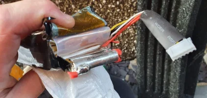

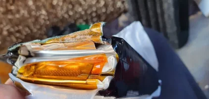

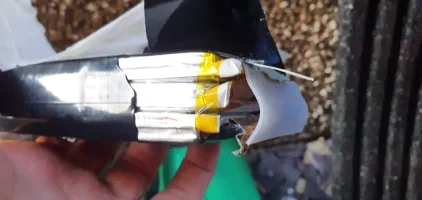

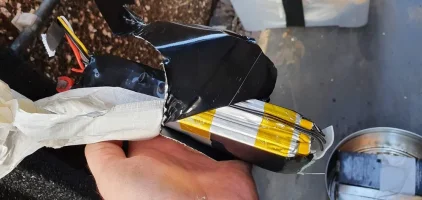

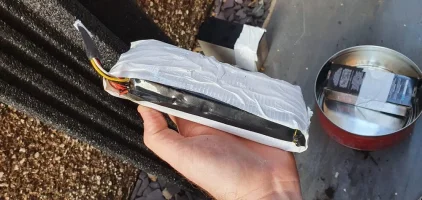

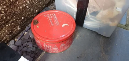

I've still got the Lithium cell from the GB150 that i killed in the tent last summer.
it seems unbranded . . . but either 3 or 6 pouch cells . . .
i keep it im my "explosion containment pie dish" . . . .
it looks like this . . .
20201107_124624.jpg20201107_124709.jpg20201107_124722.jpg20201107_124752.jpg20201107_124819.jpg
as you say not mega amount of Ah capacity, but what it has got it can dump very quickly...
