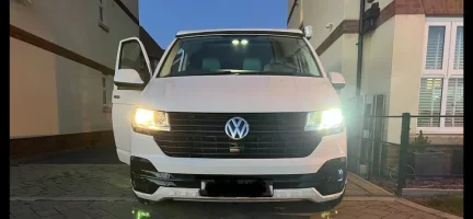

I’ve just installed my new transporter hq lights with the HQ bulbs. I have to say. Don’t hesitate. Go and get them! Takes 90 mins to install and is very easy to do on your own as I did. I am not handy at this kind of stuff. Pic isn’t main beam. That’s my normal driving lights. World of difference. I hated driving at nights with my h4
