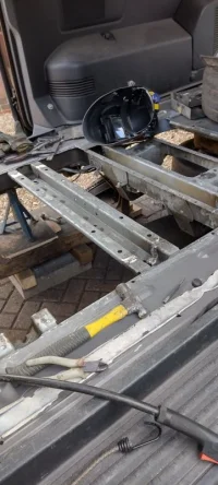

Just before Christmas I bought a low mileage t6 which had been professionally converted for rear access with a wheelchair and hand controls to aid driving. With help from you guys and a visit from Dav tec I managed to remove all the hand controls and return seating and driving to standard (still some elects to sort for the ramp and tailgate controls. This post is a quick summary of the work involved in chopping out the wheelchair ramp!
The rear bumperettes, and ramp cabling were removed along with the ramp sections that could be unbolted

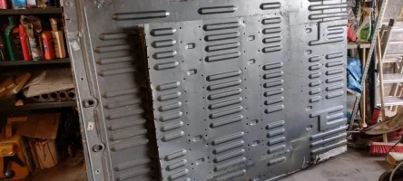

I bough a 'floor cut ' from a breaker which arrived much bigger than I asked - this proved to be very useful

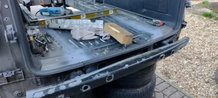

To maintain rigidity, I opted to chop out the ramp in two section, the rear up to the inner wishbone crossmember then the rest.
The rear section was cut from the floor cut in one and welded in place
The rear suspension, exhaust, fuel tank and guard, undertrays and parking brake were then removed and the remaining ramp sub assembly cut away in sections.

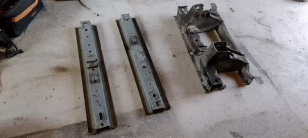

I cut the floor so that the replacement would be sitting on the chassis flanges and invisible from beneath. The ends of the chassis rails were then all marked out and squared off in preparation for installing the new floor. Because of the accuracy required, I opted to remove the floor skin from the purchased floor cut by drilling out all the spot welds! The replacement chassis rails were then accurately measured off and cut from the replacement chassis.
The chassis rails were then accurately trimmed and welded in place

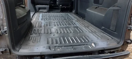

Finally the sheet floor was trimmed and welded in place
Just the underside to re build then on to next phase!

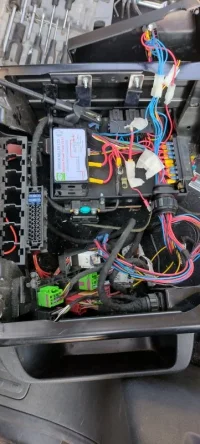

Carrying on with the removal of the electrical mods - pics attached of the electrical control box under the passenger seat - now removed - and the second control box from the near side rear wheel arch. From the rear box, there are connections to the ramp motor, to the hand held controller for ramp and tailgate, to the front power supply box, and two wires which are connected to two brown wires which disappear into the roof. I have disconnected these and removed the whole lot. Tailgate works fine from the tailgate switches - the only issue I have is what these wires are connected to as they somehow controlled the tailgate operation. I have also discovered that the tailgate power latch - not currently fitted - is electrically connected to a box bolted to the wheel arch, not to the mobility add on box - is this the original Vw fitment? I have plugged the power latch in and it doesn't currently operate. Any help greatly appreciated and if anyone wants anything from the control boxes give me a shout!
Final piece of the jigsaw!
Everything extra that had been installed in the as part of the wav conversion has now been removed with the exception of
Electric parking brake - this is now a stand alone system and I will retain
The two connections from the rear control box which have been spliced into the rear loom. These have disconnected and taped up at the box and now I have removed the headlining, can easily be de soldered. For my interest I wondered if any electrical guru could advise what they are connected to?
One wire is spliced into white cable numbered 219, and the other to 54 - I have been unable to find these on the current flow diagrams.
219 could/should be ground - mating with brown wire at the connector.
By any chance 54 - 3rd brake light? (as per DIN terminal designations)
What colour wire the "54" mates at the connector (or what pin)? (For brake light would be black/red - pin 8)
Skyliner - tailgate unlocks from fob but does not open - fob has a tailgate button
Mmi - both wires were connected to the rear control box installed by brookmiller to operate tailgate and ramp ( now removed) from a separate hand control on a flying lead so shouldn't involve the brake light. I have had a play this afternoon and if I ground one of the wires it opens the tailgate, grounding again opens it. The other one does nothing when the tailgate open but when closed it sounds like the strut motors try to run but tailgate doesn't open!
