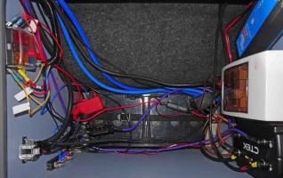

None of this stuff is fitted yet, in fact the orders were only placed in the last few days with the exception of the Renogy unit which I bought in November.
Many thanks to all who have given advice either unknowingly or otherwise, my wallet salutes you!
The TN Power 100ah was a bargain price from a well known Battery err large store who listened politely to my explanation that Inverness and the Highlands were indeed a part of the UK and therefore I was not sure why they wouldn't ship to my address!
The EHU charger was a bundle deal with the TN100 battery and I thought it might be a little underpowered at 10A out but it will just take a little longer right?
Solar Panel: PhotonicUniverse EFLXBJB-160M 160W 12V ETFE Black Flexible Solar Panel
Mobile Panel: None. Hoping the 160w panel on the roof will do the job.
Solar charge controller: Renogy RBC50D1S-G1-EU
DC-DC charger: Renogy RBC50D1S-G1-EU
EHU Charger: Victron Energy Blue Smart IP65 Charger 12/10(1) 230V BPC121031034R
battery bank: TN Power TN100 12.8V 100AH Lithium Battery
Battery Monitor: None yet, any suggestions? The charger will have Bluetooth but no other monitoring has been bought yet.
Inverter: Will wait and see if I need one, not sure what I would use it for.
