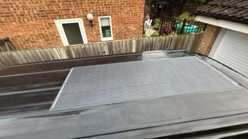

Well, my panel has been on for a couple of weeks now. First real test was Latitude Festival. Facing North-West with patchy sun and cloud (and heavy rain at times), my 100Ah Renogy Lithium reached 100% every day. Fridge running on coldest setting drawing 3-5A (and 30+Ah per day). Charging phones and bricks for the whole campsite…
In best conditions, given that I wasn’t facing the right direction, and that my Aurora is about 15 degree incline when ideal is 35 degrees or so, I got up to 200 watts and at cloudy times I was still getting 50 watts or so.
I’ll think I’ll be able to camp off-grid perpetually three seasons of the year, and come winter, I would be able to stretch 5+ days (though unlikely to stay in one place this long).
Really pleased with the outcome; Victron MPPT is amazing, the panel looks great on this roof, I used Wago connectors inside to connect to previous wiring, and coped with the nerve-racking challenges of bonding and cutting a new hole for the rear junction box!
Thanks for all the advice chums. Let’s now hope for more than 4 years on this one…
