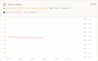

That SB trace looks odd! I was talking about the setting you used on the AMT.
I left mine on the default setting 4.
Looks like your SB is going down to 11.5v?
(Could be my eyes?!)

Here's a yesterday's screenshot of my batteries behaviour, the bottom green line is the SB, held steady by the AMT at close to or around 12.3v.
Hmmm I think I might have a problem with the AMT.
That looks a lot more normal than the shunt data from earlier. The SB will have a gradual decline over a day with the various parasitical loads attached to it, the AMT won't make its presence felt until the SB voltage is under 12.3v. Use your Lamborghini instead of the van today and let's see what the plots look like at 9pm.
This is a useful view from the Cerbo, you can clearly see when I opened the van earlier to retrieve a special pair of pliers, and the AMT recovered things after the voltage drop.

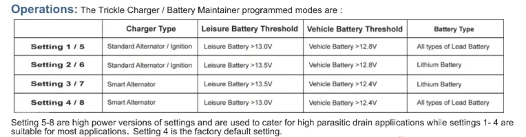

Oh wait, I think I have read the guide wrong, setting 4 is for a smart alternator and lead acid batteries, setting 2 is for lithium batteries. I think that is meant to relate to the SB not the leisure battery. I may have set mine up wrong.
The battery type refers to the leisure battery. For a T6 you want setting 3 or 4 depending on your LB type. Or settings 7 or 8 if you have high parasitic loads.
I’m using setting 3 and it works great, but many others have left it in setting 4 with a lithium LB and get good results too.
I have a 2016 T6 Kombi T32 converted with a new leisure electrics install which includes a Fogstar 230ah seat base battery and a standard starter battery that might need replacing before too long - the Ablemail when working should keep it going for longer as it will help maintain a good operating voltage.
Is setting 2 wrong that I currently have it set at?
Assuming you have a smart alternator on a 2016 (I believe it should!) then ideally it should be in setting 3/7 (or 4 as noted previously). It will still work in setting 2 just not ideally.
