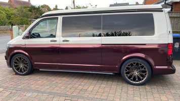

Team LV-1. Great wheels.View attachment 253959View attachment 253960
20th wedding anniversary so I bought myself new alloys ….. sorry van wasn’t washed but haven’t posted a pic of the campervan for a while.
Think I might leave my van on your drive on the off chance some work gets done on it.
