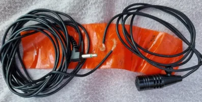

Anyway, that’s a lot of words to get to the punch line which is that when I got the A Pillar off, the first thing that I saw was the mic cable with a length of bright orange plastic tape wrapped around it and as I started to take it out, it fell apart to show what’s in the picture at the end of the post. It’s pretty obvious that the Autoglass fitter managed to cut the cable when he was doing the job and instead of coming clean decided to just keep quiet and stick the cable out of sight in the hope that there wouldn’t be any comeback – I even suspect that the orange tape was part packaging from the new windscreen. As it’s now over 4 months since he did the work, I reckon he’s right about no comebacks as at this distance Autoglass aren’t likely to accept any blame and the bottom line is now that it’s sorted (at a total cost of under £20), I could do without the aggro of complaining.

That break in the wire looks like it was originally wired into a shunt or a wago or even earthed to the subframe behind the A pillar perhaps with it being cut, trimmed and twisted? Unless the AG guy tried to fix it? If he fishwired your old screen out he likely wrenched it off whatever it was on. Where abouts in the A pillar was it roughly? In the top corner? I might be takin the trim off on mine in the coming days. I could have a look see how mines set up.
It's a microphone and the only thing that you can do with it (at least when it's whole) is plug one end into the appropriate socket on the head unit and talk into the other. It was working before the new window went in and wasn't after. I can't begin to guess how it was done as I don't know what they do to fit the new screen but I suppose I also got lucky in that it was bound together in a loom with a whole load of other cables but that was the only on that got cut - thinking about it now, it was towards the top of the A Pillar and the break may well have been before it got bound to the rest of the cables (ie. just after it came out of the headlining to begin it's downward journey. It's just another one of those things that I will never know..
I also forgot to say that the first thing that I did in the repair operation was take the head unit out and plug the new mic in to see if it worked - it did so immediately and I then knew that I had to start dismantling to do the job properly. If I had gone through all that only to find that the new mic didn't work either and there was something else causing the problem, I think I might haver topped myself!

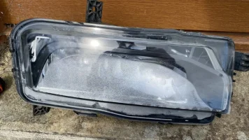

Removed the front bumper so I could replace a broken bumper bracket and also removed the fog light that was full of water and dried it then sealed the glass up with a good smear of silicon sealant.IMG_6798.webp

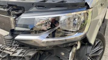

Replaced the front splitter which was removed to have the bumper painted a couple of weeks ago.

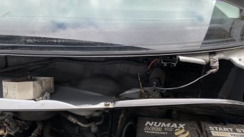

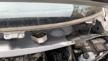

Then I removed the wipers and scuttle and wiper motor and did the sound deadening with dodo hex and dodo noise insulation.
