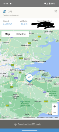

Also mounted a USB GPS receiver hidden in the white plastic by the passenger door for the Cerbo GX, which appears to be working:
It doesn't need to be super accurate, just needs to track location within 100m or so.

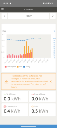

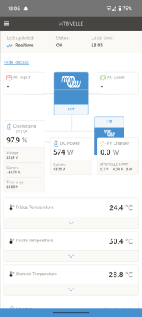

So, aside from adding a Victron touch 50 when I've got somewhere to mount it, that's my electrics fully completed!
230Ah of LiFePO4 battery
50a DC-DC charging
305w/20a MPPT solar
2000w inverter
And all the monitoring under the sun thanks to the Cerbo GX!

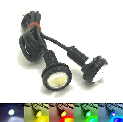

Installed more DRL’s in my sportsline front skirt. As obviously the DRL’s in my headlights, bumper and under the bonnet just weren’t enough :geek:
Splashed right out on these though. £4.34 for 4 of them off eBay. So I’ve a spare set if they die.
They’re super bright too. Wired them up so they come on with the ignition. Dead easy to fit.
