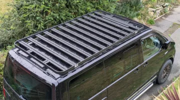

Looking great, Steve fitted the same suspension set up to our van, hope you like the drive as much as we do nowSpent a metric f*** ton of money on it!![]()
@CRS Performance for:
Koni Special shocks
Std height springs
25mm lift spacers
Lower front arm bushes
H&R anti roll bars
New drop links
Rear discs and pads
Alignment
And then onto flatdog UK for roof rack fitting, already paid for.
Result:
Suspension is massively improved, it's settled over normal 'smooth' roads, I'm not feeling every single bloody imperfection in the road and it's just a whole load more comfortable!
And it's about 4" higher than it was before!
The rack is excellent, really good mounting system and there's very, very little wind noise - if any.

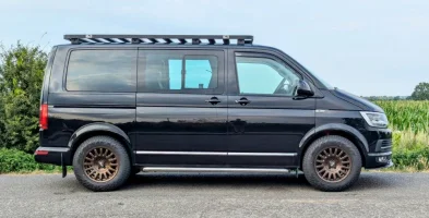

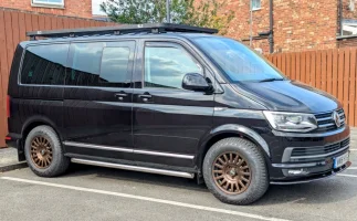

looks fab however it doesnt look lifted it actually looks lower than a standard set up?Spent a metric f*** ton of money on it!![]()
Koni Special shocks
Std height springs
25mm lift spacers
H&R anti roll bars
New drop links
Rear discs and pads
Alignment
Result:

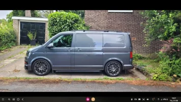

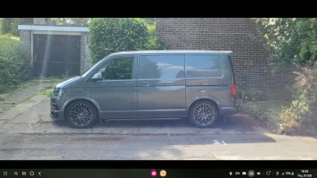

It's not +25mm over the std 460mm, you're right - but it's the extra weight of the caravelle that means even with the T32 springs and the 25mm lift kit it's not as high as a panel van would be.looks fab however it doesnt look lifted it actually looks lower than a standard set up?
Sure however this is a standard t32 shuttle on standard shocks and springs and bigger tyres and it seems higher than yours with a lift kit? Anyhow doesn’t matter yours looks nice.It's not +25mm over the std 460mm, you're right - but it's the extra weight of the caravelle that means even with the T32 springs and the 25mm lift kit it's not as high as a panel van would be.
Bear in mind also the big-ass tyres full the arches a huge amount compared to normal so that gives the appearance of being a bit lower.
Edit: just braved the rain to check - it's sitting at 450mm centre to arch all round. So without the spacers it would be 425mm!
10mm lower than std height. Add in the 30mm gain from the tyres and I've gone up by 90mm - 3.5 inches!
Yeah I'm happy, would have like a bit higher but it's not the end of the world. They had the rear much higher than the front but to get it closer to level needed the rear dropping with different springs. If I wanted it really high then you'd into the realms of super heavy duty springs which would make it stiff as hell which is going away from what I wanted!Sure however this is a standard t32 shuttle on standard shocks and springs and bigger tyres and it seems higher than yours with a lift kit? Anyhow doesn’t matter yours looks nice. View attachment 253138
