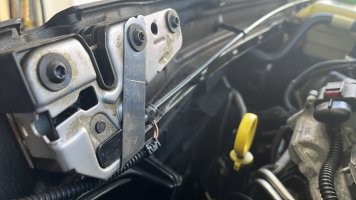

Modified my bonnet lock assembly with a plate to secure the release cable after a accidentally popping the cable off the other day and locking the bonnet down!!!
Cut a strip of stainless and bent a hook on the end to grip the lock plate, fixed under one of the existing securing bolts. Should ensure the cable never pops off again.
Seems like this is a thing on T5's but haven't read anything on here about it regularly happening to T6's.

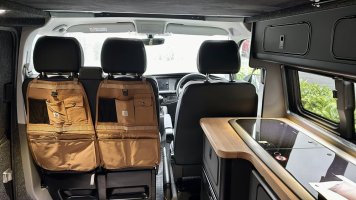

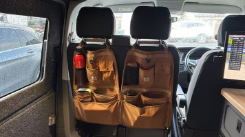

Now thems some proper seat organisers, I like those............alot.
I like them so much I even ordered a third for the drivers seat! Already finding them incredibly useful for all the bits and bobs. The colour adds a bit of ‘warmth’ to the van too. They’re a bit more than I wanted to pay really though….
How have I missed these? Gonna have to get 3 for the back of the 2nd row.... then change all my interior to tan leather from black to match them! Ha ha.
