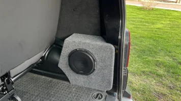

Busy day today - what better way to spend Xmas Eve than working on the van :thumbsup:

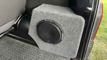

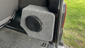

  1. Removed the jack mounting and fitted the other wheel arch sub enclosure.
  2. Wired them in series parallel as they are dual coil so I ended up with the 4ohm I needed at the amp.
  3. Refitted the amp and DSP under the passenger seat after trimming the shelf they are sitting on so that I can use the OEM rear seat base plastics. The first version I made wouldn’t let the rear cover fit :whistle:

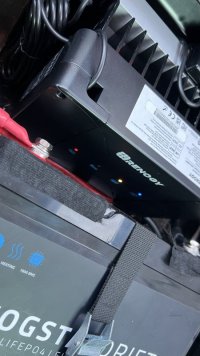

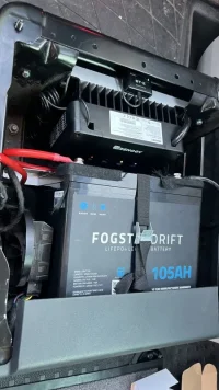

  4. Hooked up the amp main feed with 4Awg wire to the new leisure battery fuse box I installed yesterday
  5. Fitted a 12v usb socket under passenger seat to power wifi hotspot from leisure battery fusebox
  6. Refitted both front seats
  7. Plugged the DSP in to the laptop to tweak the tuning
  8. Annoyed the wife with the engine running and bass thumping :D
