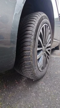

What I haven't managed to do to my van today is get the Cross Climates I ordered from Blackcirles on Monday fitted following my pothole incident.
What I did manage to do after about 4 hours on the phone and visiting various tyre fitters (that were not the one I asked for) is to get the tyres.
So currently the Caravelle is seats flat with tons of protection over them, the front load guard in and 4 new tyres and one buggered tyre and wheel sitting on top.
I'll say one thing, nothing makes you drive like a limo than the thought of that lot sliding across the leather and smashing into the fancy lining panels :unsure:
So BigTruckie now has 4 shiny new CC2s on each corner and I'm a lot happier about the coming winter.
My Rant-o-gram to Blackcirles resulted in 10% off the order so in the end it cost about £700 (plus nearly a day of my time driving all over the place and a good chunk of sanity)
Also shout out to my local ATS who not only did the fitting at almost zero notice to get us on the road for the weekend but also offered to re torque up the bolts gratis the morning after as the technician was a little concerned about the amount of cleaning up of the hubs he had to do and how the wheels would settle in.

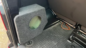

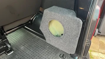

Received my sub wheelarch boxes from @Eclipse Custom Vans, so offered them into position. Will need to remove the Jack mount from the nearside Wheelarch or adapt the box somehow.
They look good anyway and they don’t interfere with the Kombi bench in the third row. Cheers Ian.
Nice one. Yep you'll need to remove the jack mounting. If you drill spot welds out you can refit the bracket at a later date if needed.
