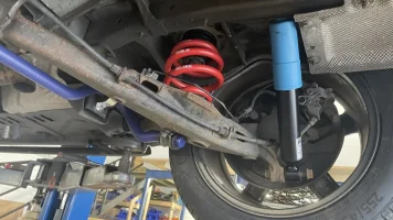

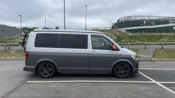

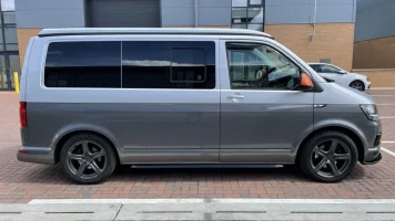

New H&R coilovers and ARBs courtesy of @CRS Performance
They raised the rear fractionally and dropped the front to give some rake from the previous, underspeced H&R springs with standard shocks. The old setup was very harsh, uncontrolled and sagged at the back due to the camper weight. The handling and ride is now much better and much more composed. It’s on the firmer side rather than going for max comfort as I wanted to keep some drop and sharper handling. A pothole is still a pothole, but it’s got rid of the horrible shudder through the whole chassis. There is also almost no pitching during braking or acceleration and lean around bends/roundabouts is greatly reduced. The damping and chassis control is a quantum improvement. For a van it is now remarkably composed on tricky, bumpy B roads and challenging surfaces. It is also much more stable at speed on the motorway.
Overall, I’m very happy. Steve and the team were great and lived up to all the previous comments on here. It was like watching an F1 pit team at work, stripping and reassembling all four corners in a little over an hour. Great work. Thank you Steve.
Before:
After:
Under:

I do understand why you had the work done and yes it makes the drive better and stiffer.
But for me, after Steve had replaced all my shocks and springs and updated the ARB with H&R, it was like I was always sliding off the drivers seat towards the pedals.
Like I was sat looking at the floor and not looking at the horizon.
The California didn’t sit in a horizontal position.
The coach line from front to back, is now slanted down at the front.
If the drive is perfect for you then that’s great stuff, and Steve does an awesome job if that’s what you want.
Just wasn’t for me.
Mine was a FWD MY20.
Put the stock suspension back on and sold it.
Picked up a new MY23 4M.
The driving stance and suspension on my MY23 4Motion is totally different and rides perfect with no need to touch the suspension.
No rocking and rolling, no diving when braking.
VW really sorted the MY23 4M suspension out.
No idea what they did. But it’s solid.

Unfortunately the budget didn’t stretch to a new 4M so had to fix what I have. :( I haven’t dare tell SWMBO what todays visit cost yet!! The photo exaggerates the rake (sloping car park and background) and there is absolutely no sense of it when aboard. All it’s done is level up the previous crap setup that had an 80mm drop at the rear and 50mm at the front because the springs (40mm drop) were not suitable for a camper conversion. The drop now is even at both ends so puts the van back to standard rake, albeit lower. Once loaded up it should run pretty close to level rather than pulling a wheelie like it did before. At least if I find I keep sliding to the end of the bed I can always lift the front slightly with the adjusters!

some very unusual comments ! Standard Californias do sit lower in the rear than a normal van. , this is due to the weight of the camper equipment , not a design feature. If we fitted any kit to any van we always make sure they sit level , level means the chassis is 40 mm lower in front than the rear , ( the rake ) this ensures the steering gives proper feed back and limits under steer , no one has ever commented that they feel like they are sliding out of the seats , in reality that does happen with standard suspension due to excessive body roll from poor design standard shocks . our experience is that the 4 motion California also sits lower at the rear but of course the vehicle is quite a lot heavier , this might make it feel different . The shocks on both vehicles are the same so I can not see how they ride so different. The newer van would have 28 mm rear ARB and the H and R are30 mm so again better handling and cornering on the new vehicle doesn’t make any logical sense.
in my humble opinion the california in standard trim is the worst handling transporter available And even the later ones with a bigger ARB and higher rear springs are not much better .,
