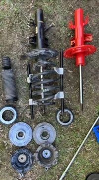

Working with those things has been one of the most scary car jobs, ever. This is back from when I did mine, there’s enough force to make the rods bend :eek:
Squeaky bum time. Mine stayed straight, but I have to admit I was on the verge of nipping out to a garage to see if they'd build up the strut/spring assemblies for me for a few quid. How have you found the shocks?
The shocks have been great, absolutely nothing to complain about. But I changed arbs, ball joints, lower arm bushes, tie rod ends and drop links on the same go so it’s little bit difficult to say how much of the improvement was down to shocks.
