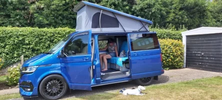

So, today was better - second front coilover and both rears done and dusted in 4 hrs.
Still think I should have paid to have them fitted but it’s done now…
STXs - front and rear all the way down - there is no weight in my van it’s just a Kombi.
Wheels next - might need to raise the front slightly but will decide when I get the wheels - not decided on 19” Canteras or 20” Navis Twins or Supermetal Cells or whether to go bronze or silver or gun metal :whistle:
View attachment 163255View attachment 163256
those claytons dont half look small when lowered! :think smile bounce:
