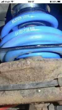

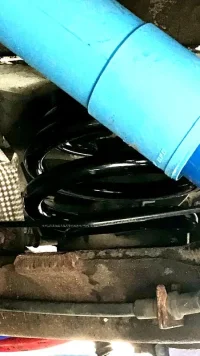

What are you lowered to buddy?So I’ve been to see Steve at CRS this morning and had the B14s removed and the H&R kit fitted including ARB’s fitted and I must say what a transformation.
They do exactly what Steve told me and it’s a lot smoother, reduction in road noise, no clattering over speed bumps, no more front end tucking in on bends All in all well worth the trip and the money.
In my opinion after having lowering springs then B14s I would miss out both of them and just go with the H&R setup.
I honestly think if you have a camper or heavy van the B14s aren’t really a good choice because of the design of the rear spring as you can see in the picture.
When I got there and before any work started Steve went through what I wanted and then advised me on what he thought would be the best way to achieve itI am so happy with the outcome and look.
Excellent job and one very happy customer.
