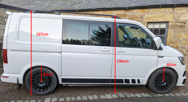

Any chance of a picture of how your van sits now, when you have time of course.

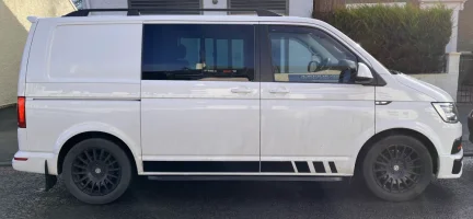

As promised. I'm really happy with this height. Great compromise on stance and comfort:
It works out as ~42.5cm centre to arch which is very close to intended.
I can also now access the spare wheel without jacking up the van
Handling wise, it is a far more comfortable place to be. I do need to get the tracking sorted though as it is wildly out somehow. So, I'll be able to comment better once that is sorted.
That is a pitty Shame it's a T30. I have a full set of stock T32 springs and shocks going spare.
Those springs aren’t copping well with the weight of your van. Go back to standard height but use T32 rear to help carry the camper weight. , we have spring spacers to trim it up exactly. If budget allows get some Koni dampers , you won’t recognise the van after.Hi steve @CRS Performance. I believe you are the oracal when it comes to all things suspension! Would you possibly be able to shed any light on the photos attached above? Cheers
