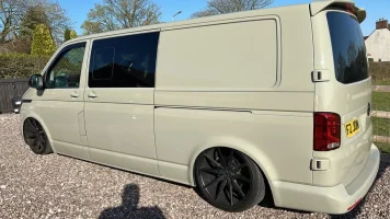

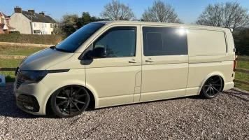

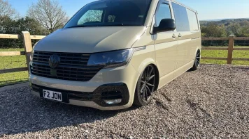

Looks amazing!!!
Did you have anything done apart from the fitting of the air ride kit to get that low? Subframe raise, inner arches cut back, chassis notching etc?
Looks amazing!!!
Mine had chassis cut and front inner arch cut, extreme hub mod and I’ve got extra low rear bags.

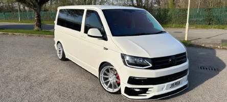

Is anyone in Team Air able to advise on offsets for 20” T311R alloys when running air ride? I am wanting to buy some T311R’s before going to air ride and want to make sure I get the width, offset and tyre sizes correct now rather than needing to change anything when getting air ride later this year.
I’ve read loads on the forum (probably too much which is where my uncertainty is coming from!). So for those that ran or run air ride with 20“ T311R’s, does 9x20 et 38 235/35/20 sound correct for the front and does 10.5x20 et 42 255/35/20 seem correct for the rear? I’ve seen some people mention running et35 all round but not sure if that helps or hinders me?
I’ve also been on will-they-fit website but that hasn’t really helped to clarify anything.
Any help greatly appreciated!
That’ll be some stretch on those size wheels, I run those size tyres on 8.5 “front 10” rears with slight stretch same offset wheels too I think . Going air mid April but looking at them now on solows there’s loads of room .
