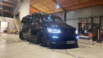

Has anyone got any photos of their vans on max lift that they are willing to share?
Slammed photos are great but never see any photos showing the full range on motion
EDIT: there are 2 sets of photos on here up/down but @The Van Cave I’d be very interested to see the travel on your standard setup offering
Are you looking for photos of fully up vs fully aired out, or fully up vs ride height, or each of the 5 presents you can have on Airlift management?
I’ll have a play with mine tomorrow afternoon to get some photos and also let you have some reference measurements for how much lower than a standard van each setting is. Would that help?
