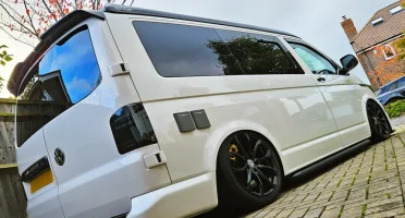

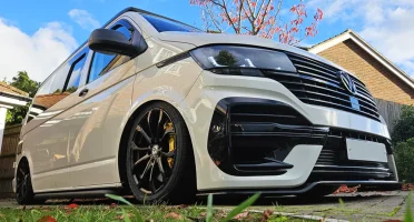

I've just finished installing a full Air Lift kit to a T32, so everything supplied by Airlift. The pictures below show the van aired out and it's still pretty low. The amount of wheel/tyre tuck is partly down to the 18" wheels, but it's pretty low. The ride quality at ride height is very good, but higher than it would be with the SoLow kits I usually use. At All up it's only 50mm lower than a standard van, so clearance for getting over almost any obstacle that you're likely to encounter, unless you're going seriously off road.
You can adjust the bag platform at the front for even higher ground clearance, and there's an additional spacer supplied for the rear bag to get more clearance at the back. With it set up like that you can reach standard ride height at max height, but the trade off of course is that it won't air out as low as in this picture.
