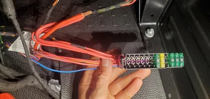

Trying to connect a dc charger to the famous red wire I’ve read so much about, but in my 2021 t6 there are 5 fused accessories coming off it, all 30 fuses each. Besides the cig lighter, I can’t find what else they could be?
More to the point, can I piggy back my charger (30A max) off this with these all still connected?
Got some pics?
They may have changed things in the T6.1?
5x 30A is 150A possible max.... thats massive! .... unless they not expecting all these to be on all the time?
Adding another 30A could take you to 180A possible max?
You need to check the size of that cable, and the size of the fuse feeding it...
Schematics and fuse box layouts are available in the downloads section.

I agree, that’s huge current draw! The cable isn’t marked but at a guess it’s 12mm and crimped to the line side of the fuse with funny square crimps.
Can anyone answer if it’s ok to use this red wire with the other random accessories?
I’d say yes, but as @Dellmassive stated, you need to make sure your cable is rated for the theoretical maximum amperage should they all be demanding power at the same time.

Just test fitting a new Powered Lithium battery. Van is a new t6.1. Wondering if I can repurpose this feed for a Victron Orion DC-DC charger and save myself a few life minutes by not having to route a new one.
I haven’t traced it back to its origin but I’m assuming it runs back to a bus that sits on to top the starter battery. It’s not connected to anything under the seat, just taped up.
Can’t find any mention of it with a search.
Any thoughts appreciated.
Starter battery Bus Bar looks like this.
If that links back to the main battery fuse box, then yes.
But you need to test it.
See if its live. Then find the main feeds at the battery.
Find same cable and disconnect and bell it out.

From looking at the relay location diagrams I'm guessing that it's the feed that would go to the 'Battery Isolation Relay' which I'm assuming is the factory split charge relay? I'll check to be sure but looks like those life minutes are in the bank!
Yes basically.
You might find that cable links back to the SA03 fuse under the battery.

Hi @Dellmassive, I'm just installing my leisure battery and found these wires under the passenger seat, I've uncovered the thick 10mm red and it is labelled with a sticker, does that mean it's good to use for the dc - dc charger? If so will I need to fuse it or should it be fused already? Thanks.
If it's factory...then.
Will most likely be fed from the SA fuse under the starter battery.
See info above..... I think it's fed with a 100A fuse?
So good for a DC-DC charger.
